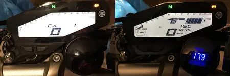

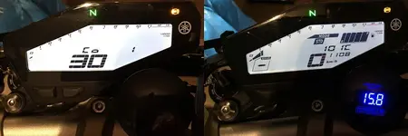

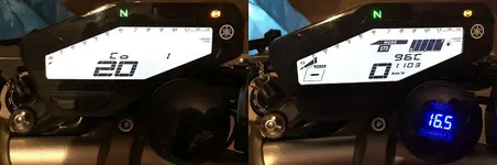

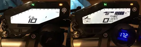

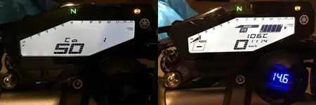

hello guys,
I'd like to share my measurements in this topic.
I have mivv full system installed and KN filter, and the result was predictable...
[video=youtube;kV99SrNaU-k]https://www.youtube.com/watch?v=kV99SrNaU-k[/video]
... puking fire
the first idea - to correct CO, but this "shamanic" 14 didn't change anything in my case. So I decided to read AFR and verify what impact does CO setting have on real AFR.
I was ttrying to catch the mediane AFR value on photos, but with increasing fuel dose the range of fluctuations was smaller and more accurate.
of course I made a mistake doing measurements with AIS opened. As it turned out later opened AIS increases AFR about 2 points.
finally I finished with "35" that gives ~13,4 AFR...
... engine works perfectly well, pops when blip throttle stopped, and revs become rhythmical, engine works noticeably quieter.
