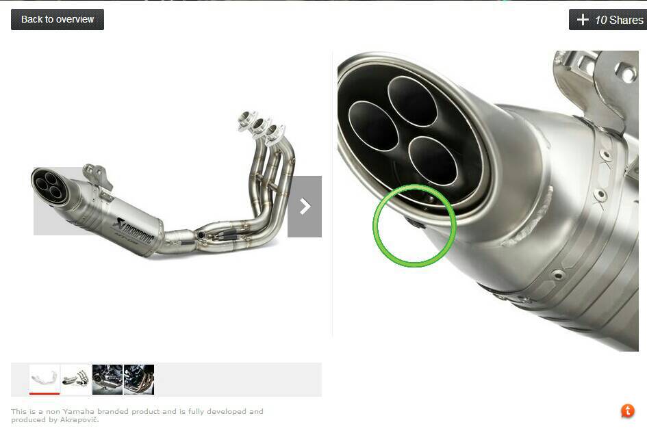

no thats part of the exhaust and stays in there. The baffle is a bitch to fit!!
I think that was the earlier 3 piece exhaust, no idea why they moved the baffle screw to a more inconvenient place
yup, my screw is right at the back n id have to reach under the chain from the left to get at it. i was dremmelling the hell out of the first flange (with the screw in) thinking that was the fouling point but soon as i lopped the tubes off it fell in there! its the tubes going into the 3 holes in the can that caused my issues.
ive lopped mine off so later on ill try the cut bit in the hole-that should show me exactly where mine was sticking. i hadnt thought of that before cos the end bit fitted ok after the lopping ceremony![]()
id give you a sound clip of mine once its fitted but a 3 min clip take 3000, yup thousand, minutes to upload over there. if anyone knows how to upload clips faster please let me in on the secret....Cool, I'm still in two minds about whether to chop mine or not. It's too loud with it out but don't have a spare so once its cut its ruined. I suppose it could always be welded back on but unless it's lined up exactly right I'll have fitment issues again.

how much louder is it out ? is it ridiculous or is it only when its revved hard ?

the bass noise? thats the bit i dont like either, the deep BOOM bit.For me its too loud when its not being revved, low down in the revs is a really deep resonating sound, once revved up it sounds ok.

Can i suggest you insert it / wedge it in backwards, the external slash cut pipes aren't as long as the internal ones so that would let you know how it will sound. I think……?
