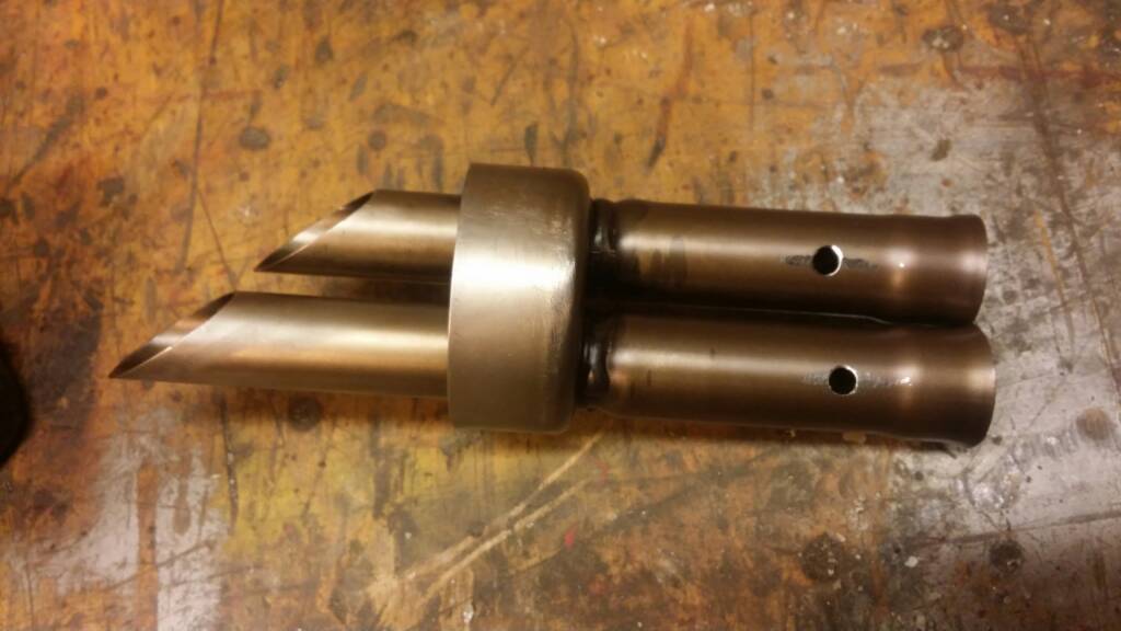

Looket at all your tips and went for the hole drilling. Starting with four 6,5mm holes and maybe adding more after giving it a good test :-)
Had a quick spinn, sounds deeper on idle and more agressive with blips of the throttle. Don't notice big difference while riding, but got to give it some more time :-) My wife have kept here Akrapovic orginal, so will test the bikes side by side tomorrow :-)

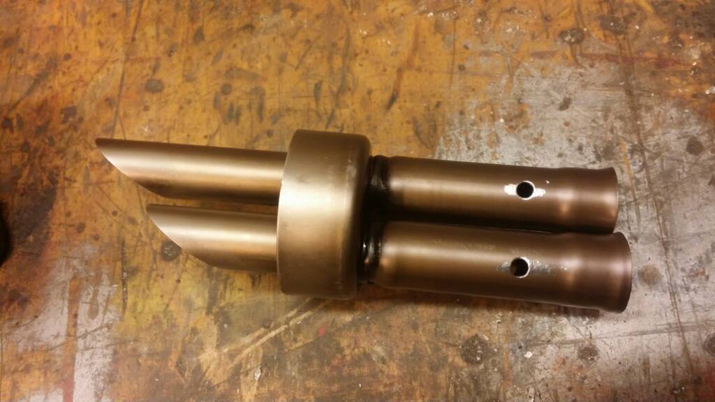

Cut those flanged sections of the end of the inside pipes (last 20-25mm). Makes removal easier too.
I was really considering it, but was affraid it would be to much. I grinded the innside of the flanged sections with a powertool, so removal is now easyer :-)

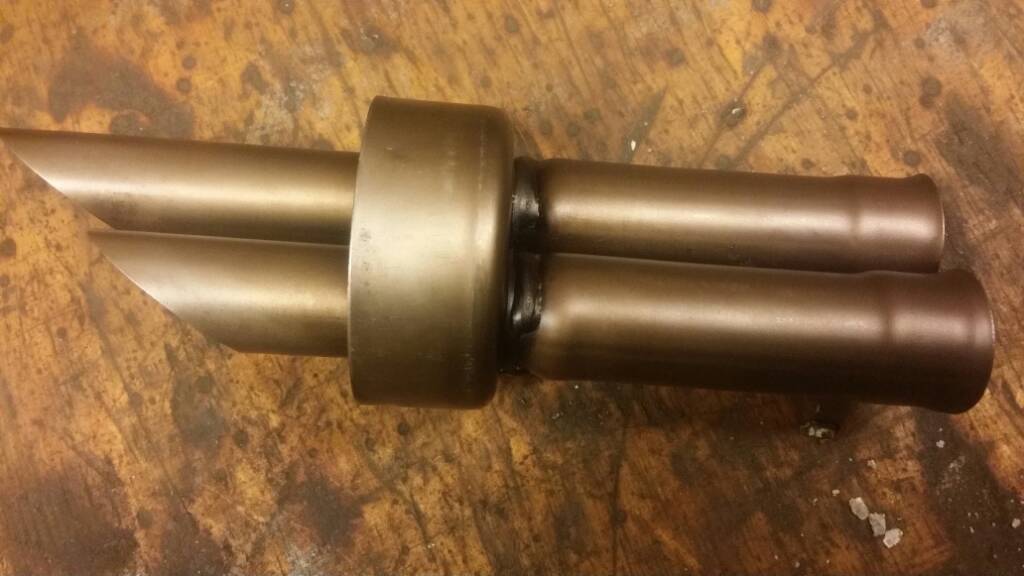

I have cut down the inner pipes to:
a. produce more sound
b. make removal/replacement a lot easier.
I started with cutting about half way down the inner pipes and progressed to leaving about 1cm - the sound difference between the 2 mods is negligible, if any at all.
To make removal/replacement easier still I drilled a hole in the pipe and db killer (roughly opposite the original) and secured the db killer with an allen bolt/nut and spring washer which makes life a lot quicker and much less hassle to remove and re-fit.
