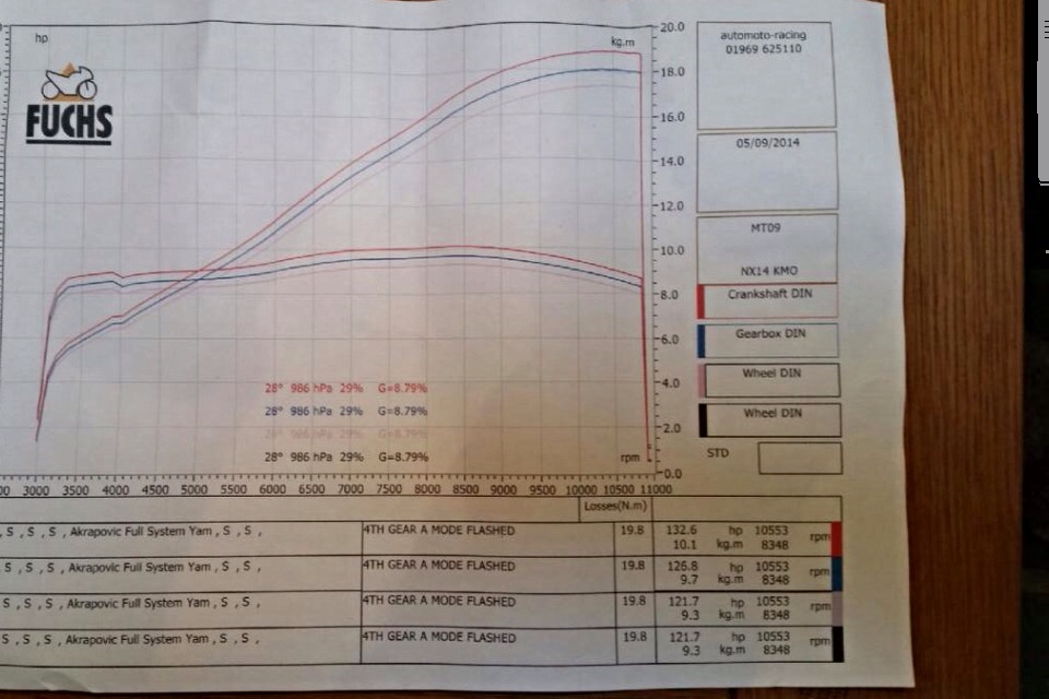

Real world fuel tank range
132.6 at the wheel
121.7 at the crank
the other way round you mean ?
yeah Richie that's another 17bhp at the wheel like a sixth more power which is a lot on such a light machine, I wonder how he does it, my concern would be reliability in case I blow it up lol .
It's all safe lol. U do t have to have all that power. U cud just get it flashed with all the other goodies. The reduced engine breaking alone sorts the snatchy throttle out. The rest is a massive bonus.
